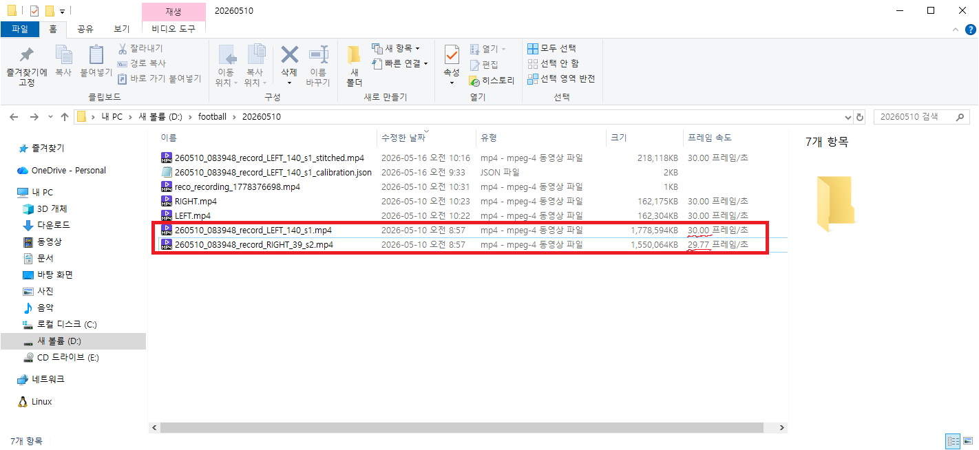

If the FPS of the two videos is different, they are synced in the preview, but not when exporting.
Video exported after setting the FPS to 30 in another program.

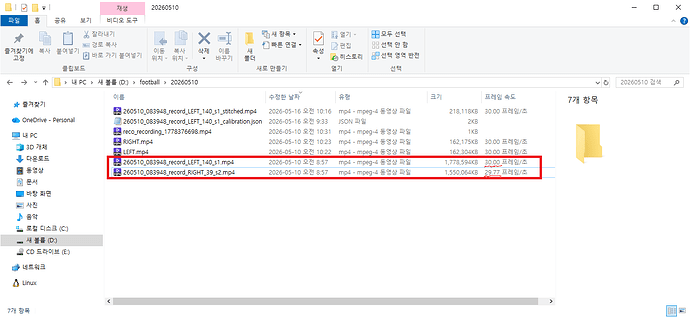

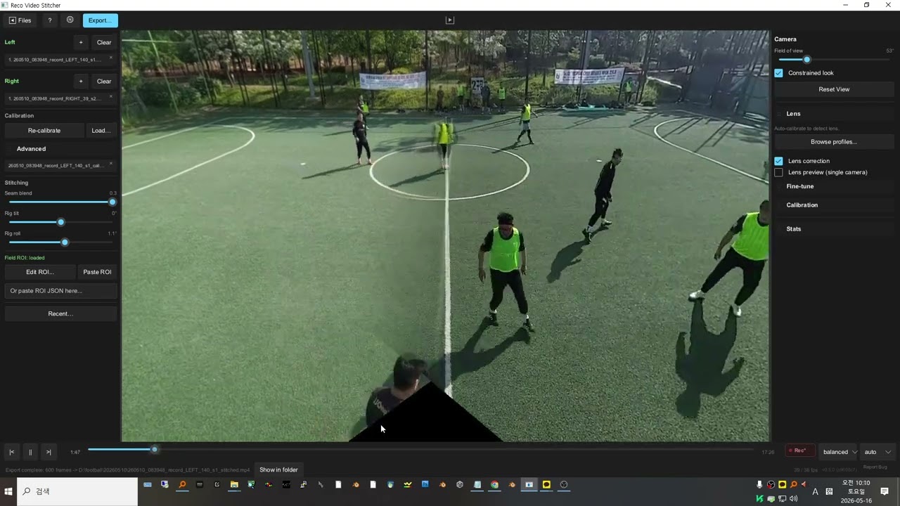

Thanks for the feedback.
Could you use the report bug button so I have access to the logs?
I want to investigate both why it was just ~25fps processing speed and the sync issue.

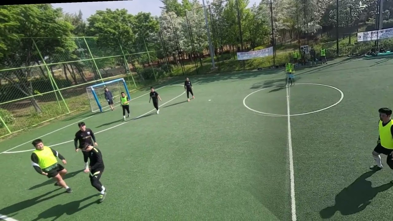

As for the visible stitching seam, it’s due to the lens profiles not being perfect. Which ones are you using here? Did you look for others in “Lens Preview”?
