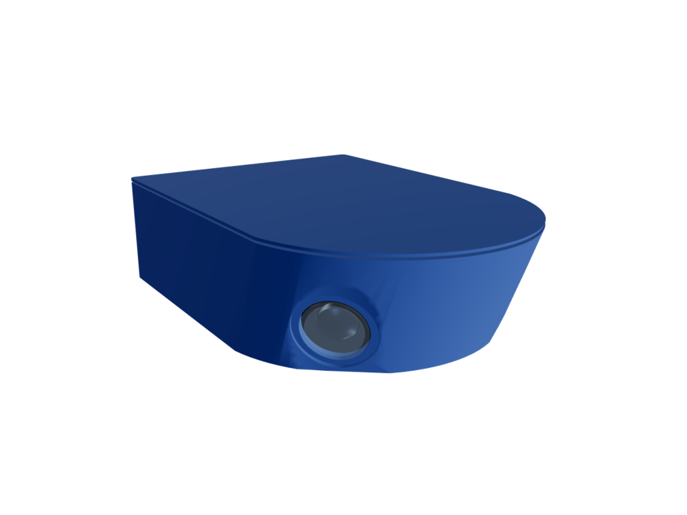

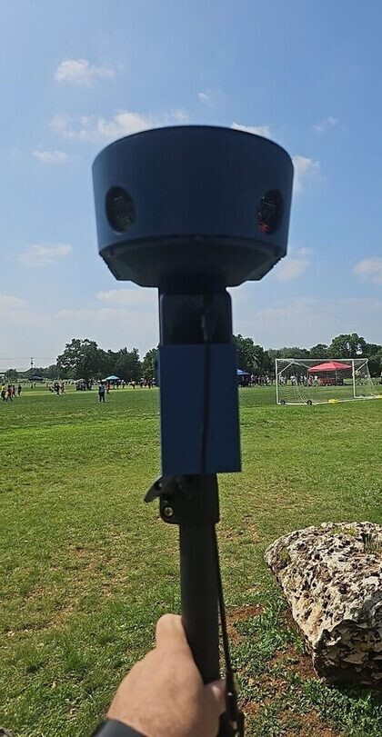

Today @Lucian_K and I are happy to show you what we have been building for the past five months: the Reco Kit, now documented at reco.cam/hardware.
The Reco Kit is a working camera that runs the whole Reco pipeline on the unit. Two sensors at 4032x3040 each, 30 fps, stitched and tracked locally, recording and streaming with no laptop at the side of the pitch. The capture is very optimised, which gives you room to build on top of it. The 3D models, the custom drivers and the code are all open. It is really meant for you to improve it. To modify the case, use better sensors, better lenses, more fps, etc… Build guides may take a little time to arrive.
