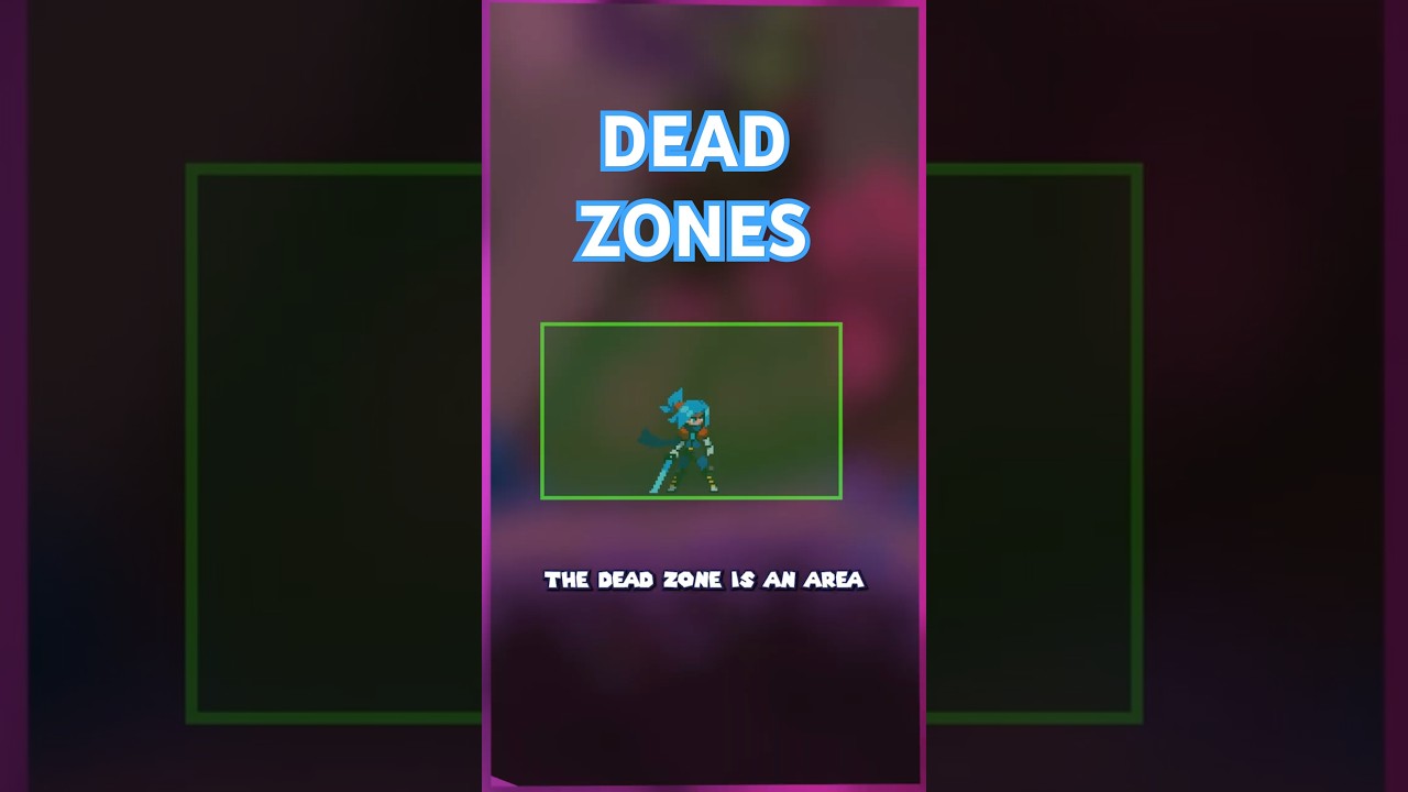

Another possible idea to address the same issue (tracking jitter) is to introduce a “Dead Zone”.
The conecpt is pretty simple, if the ball remains within a specific box central to the camera (imagine 70% of its size, centered) the camera won’t move. If the ball starts going outside of that square, then and only then the camera moves.
You could even make the bounding box configurable.
Optionally, it would be interesting to explore the option to have the vertical movement not only modify the y-axis movement of the camera, but also its zoom level, but this really is just optional.
This is a common solution to avoid lag in video games, so I’d say it’s worth taking a look at it. If I have some spare time I might try to create a little video illustrating the intended behaviour this with Godot.
